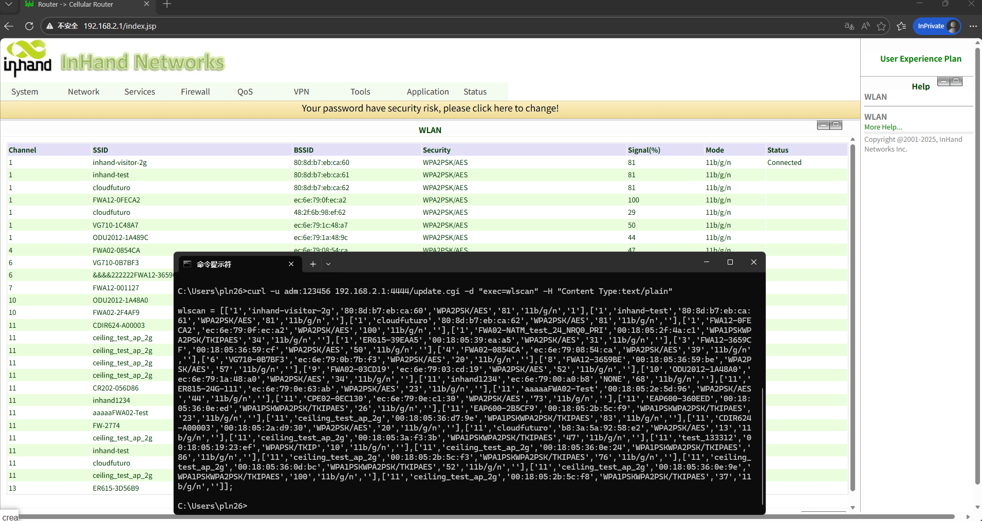

When you want to retrieve the surrounding AP's signal strength, you could use the command:
curl -u adm:123456 192.168.2.1:4444/update.cgi -d "exec=wlscan" -H "Content Type:text/plain"
You can see the result as below:

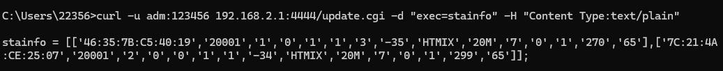

When you want to retrieve the wifi-connected devices' information and signal strength, the command is:
curl -u adm:123456 192.168.2.1:4444/update.cgi -d "exec=stainfo" -H "Content Type:text/plain"
And the corresponding parameters are:
MAC | MODE | AID | BSS | PSM | WMM | MIMOPS | RSSI0/1/2 | PhMd | BW | MCS | SGI | STBC | Idle | Rate |
46:35:7B:C5:40:19 | 20001 | 1 | 0 | 1 | 1 | 3 | -35 | HTMIX | 20M | 7 | 0 | 1 | 270 | 65 |
7C:21:4A:CE:25:07 | 20001 | 2 | 0 | 0 | 1 | 1 | -34 | HTMIX | 20M | 7 | 0 | 1 | 299 | 65
