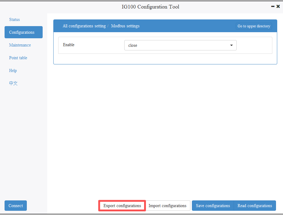

1. Configure the points table on local Config tool, and export the points table.

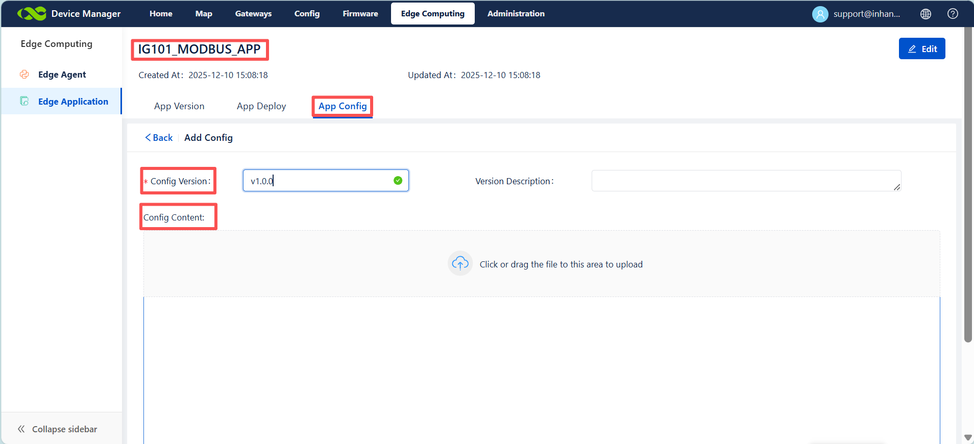

2. On DM, click the Add config under Edge Computing-->Edge Application-->IG101_MODBUS_APP to upload the point table file, then give a Config Version, the format is v1.0.0

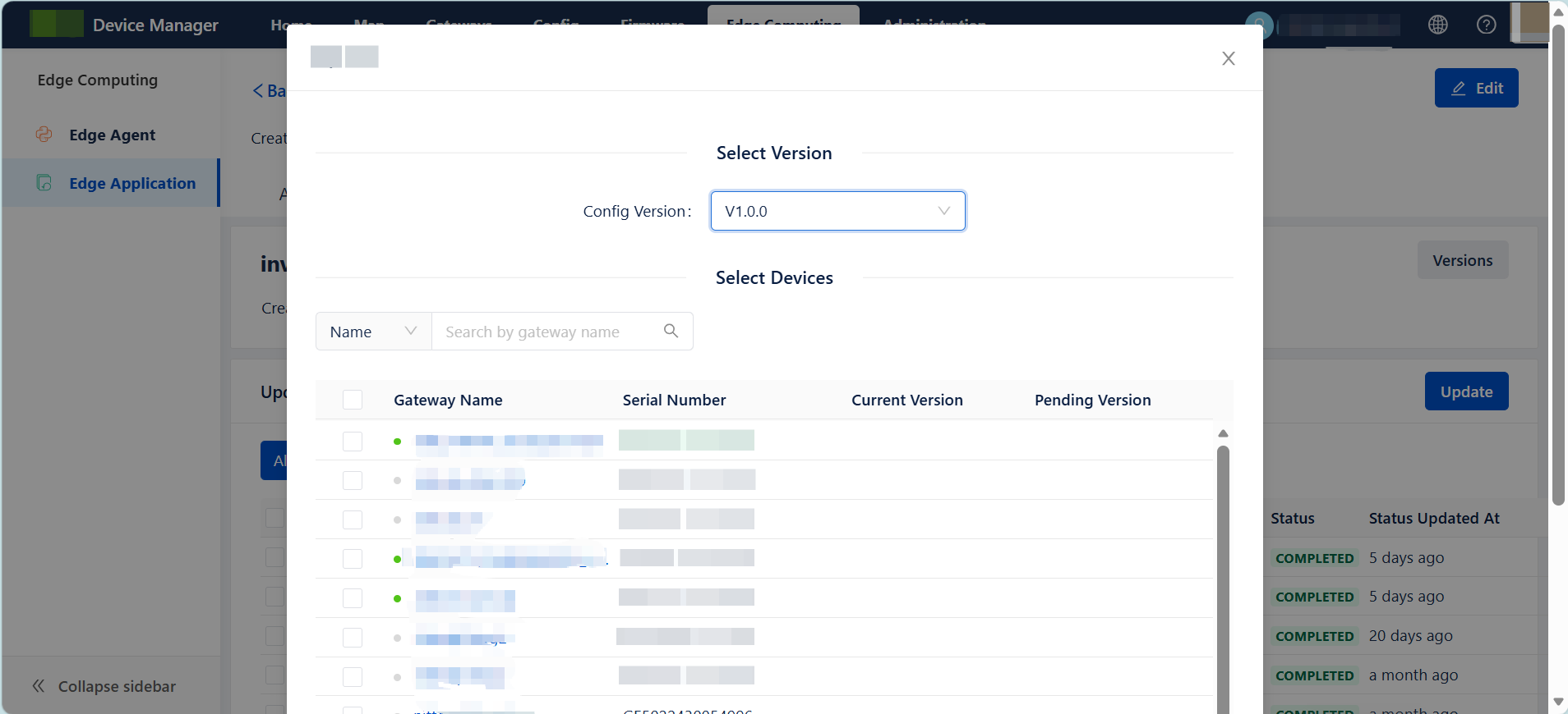

3. Then update to specific devices.
