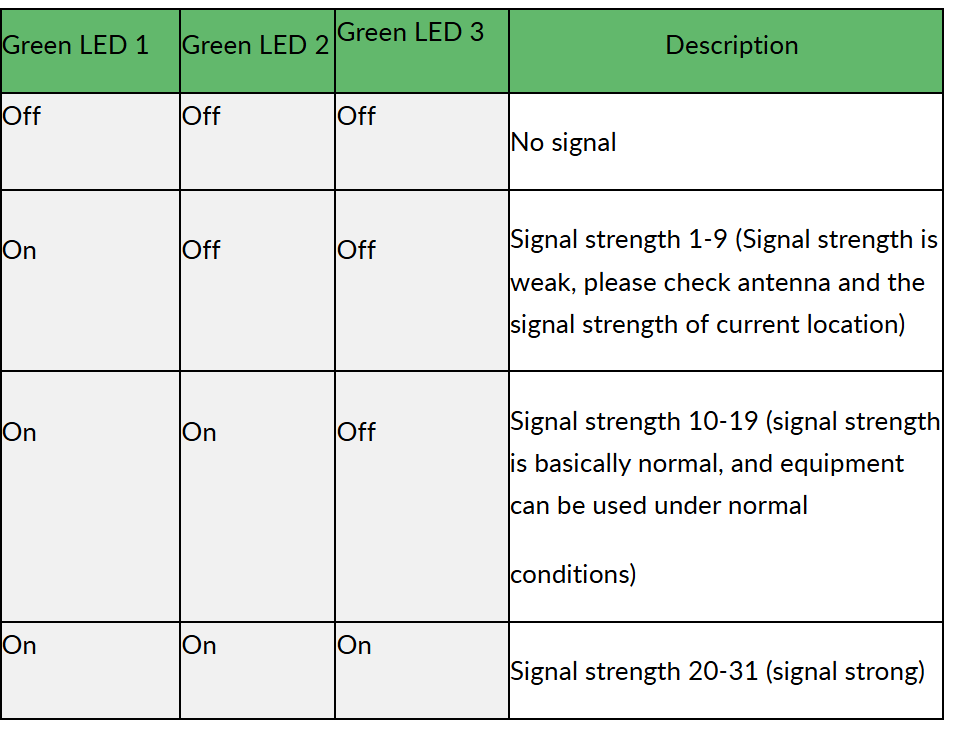

How to check the signal indicator light of IR900 router?
If all three indicator lights are on, it means the signal is good (20-31asu). If two lights are on, it means it is basically normal. If only one light is on, the antenna or SIM card needs to be checked.
