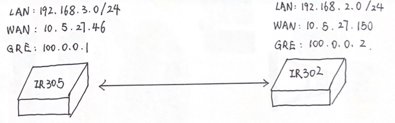

In this
example, we give a very simple topology to make you easily understand how to
configure GRE tunnel
Make sure
that the two routers can PING each other successfully.
The topology after simplifying

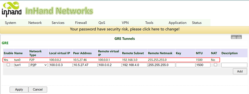

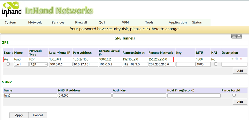

Configuration:
IR302
IR305

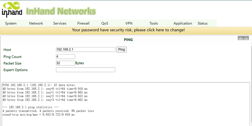

IR302
PING IR305
IR305
PING IR302
