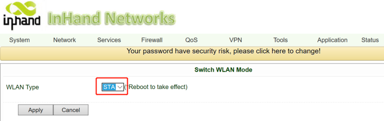

1) Go to Network ->Switch WLAN Mode, select STA.

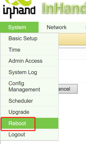

2) Reboot after apply the configuration.

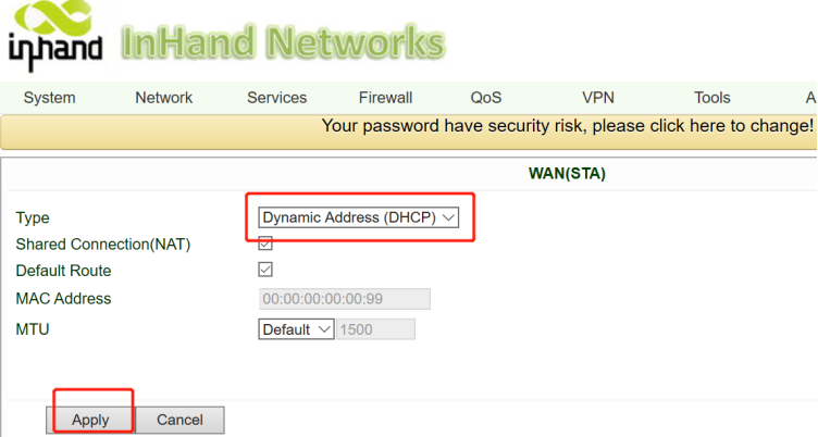

3) Go to Network >> WAN(STA), selectDHCP for WLAN connection.

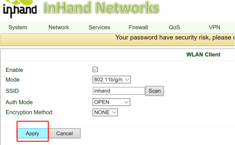

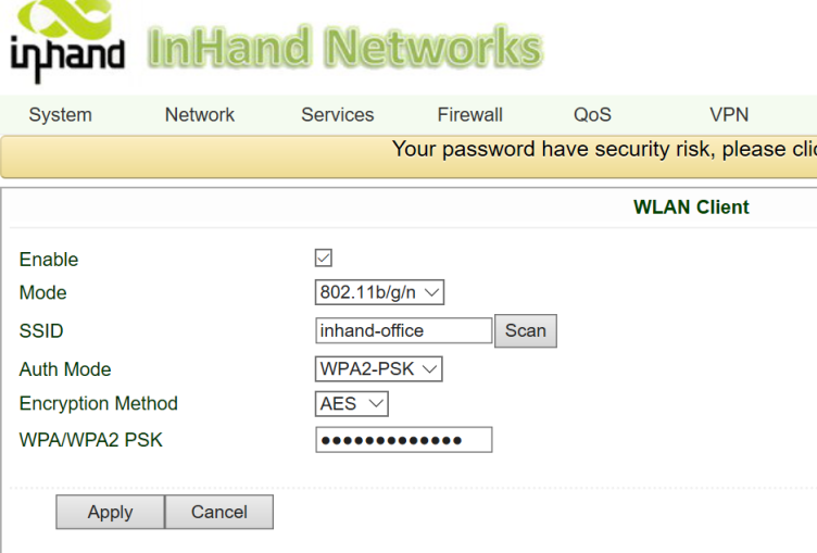

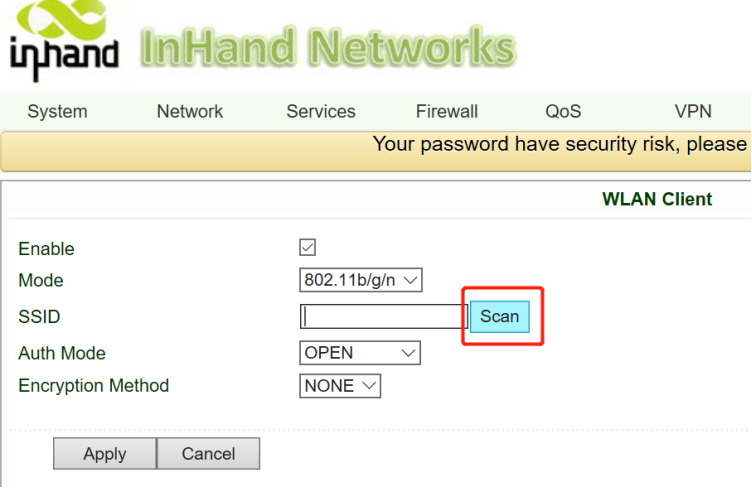

4) Go to Network->WLAN Client, apply the default configuration first.

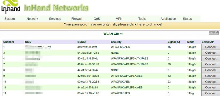

5) Click Scan, and then connect to the AP.
6) Fill out corresponding parameters.

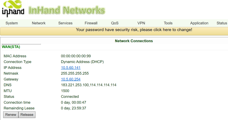

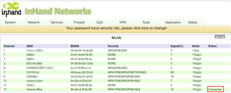

7) Check the WLAN/ Network Connection status, if it is connected.
