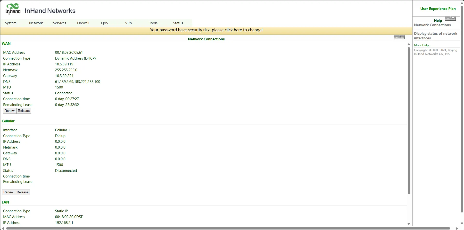

CR202 :
WAN IP: 10.5.59.119
LAN IP: 192.168.2.1

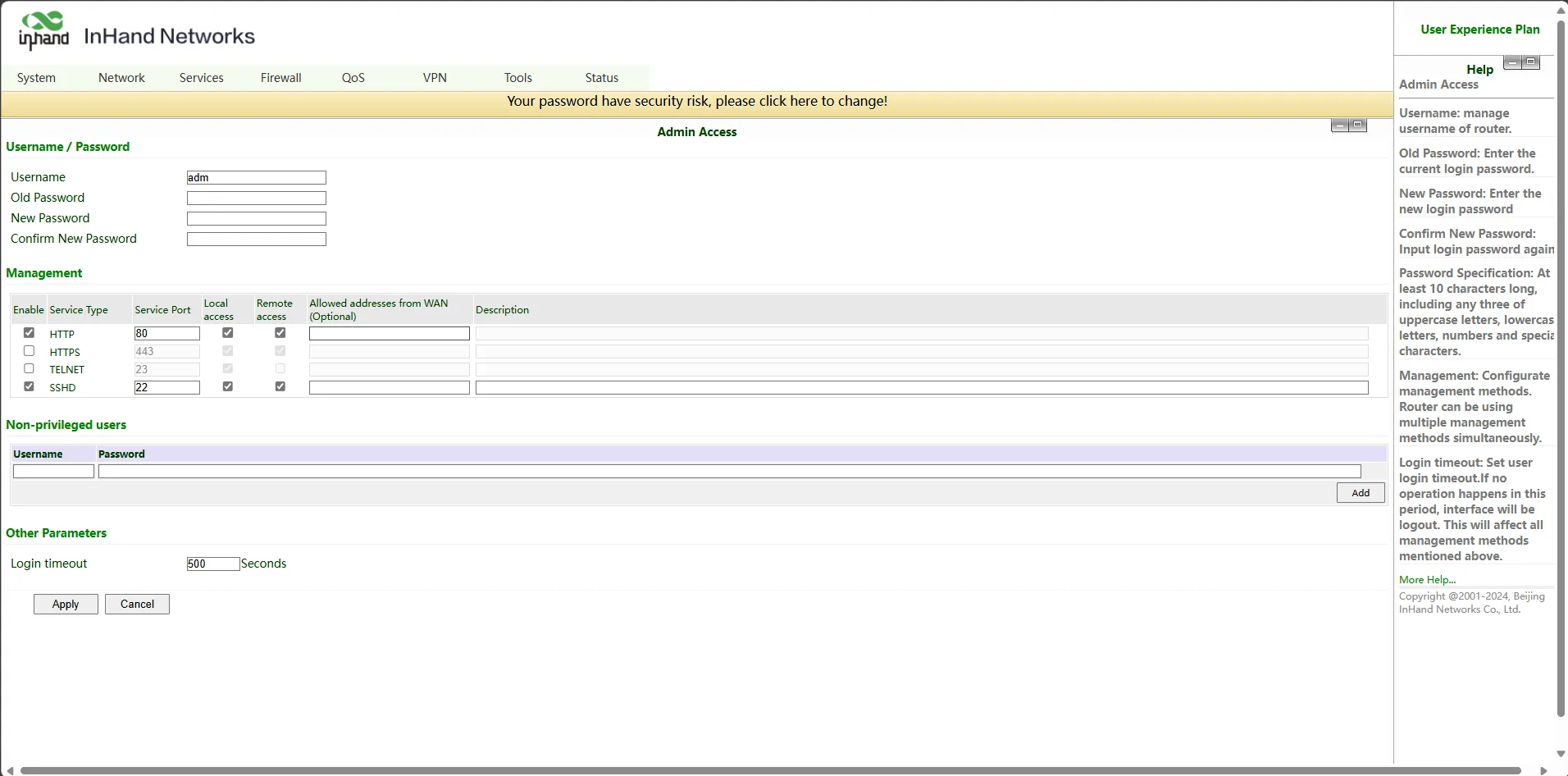

Set up WiFi AP.
  1. Make sure enable the SSH, local access and remote access.

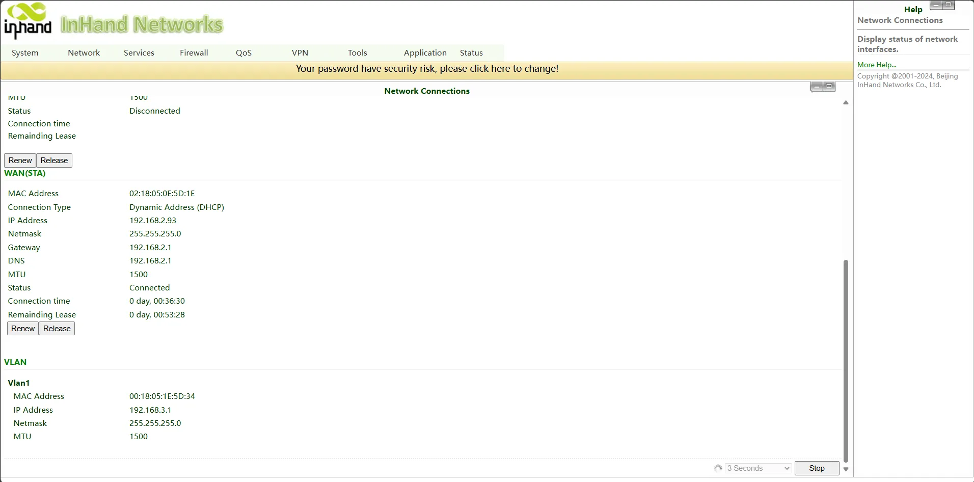

IR305:
WAN IP: 192.168.2.93

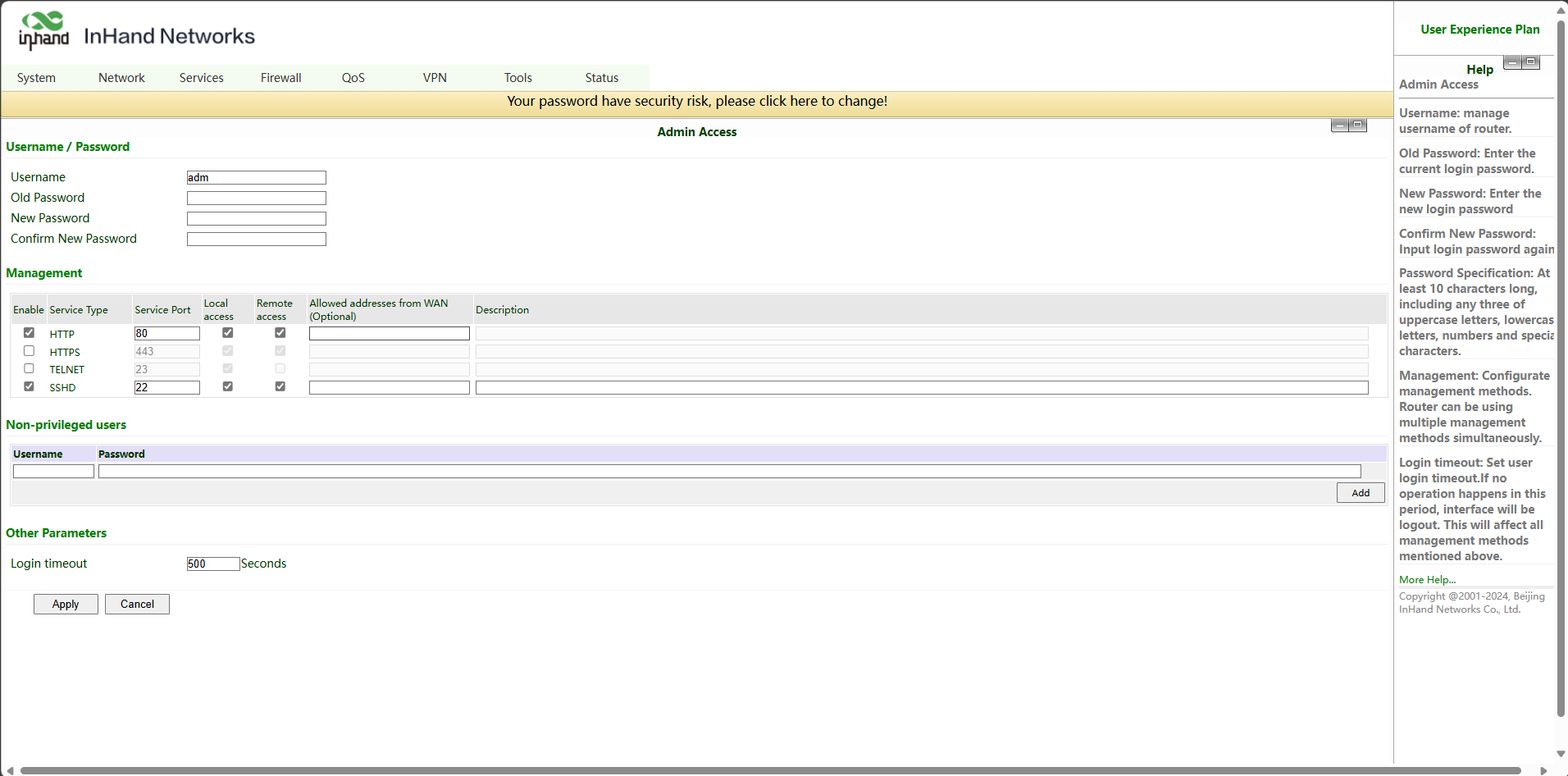

LAN IP: 192.168.3.1

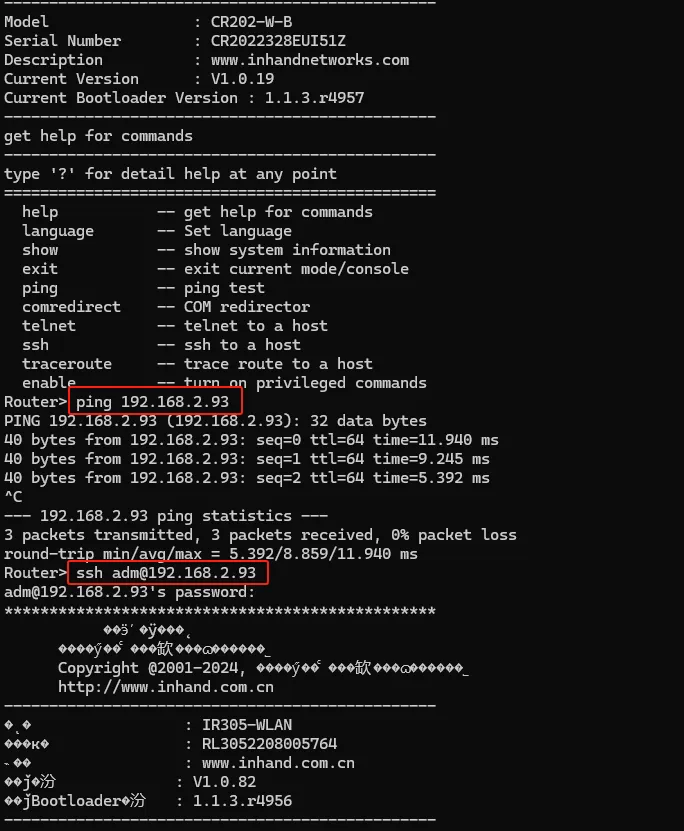

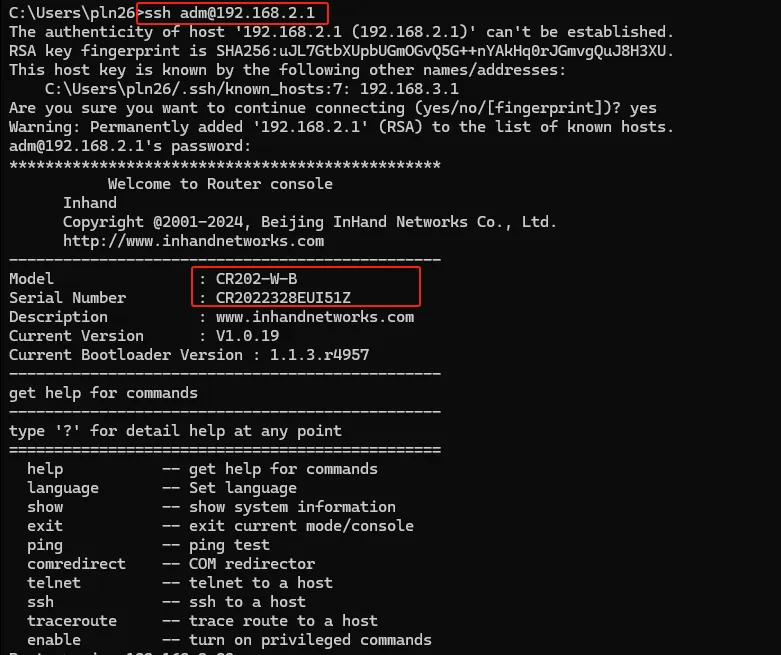

The verifying process:
  1. ssh to enter the CR202 backend.
  1. make sure the end device is connected, PING to test. Then use the command, ssh adm@end device IP, then you could access the end device's backend.
