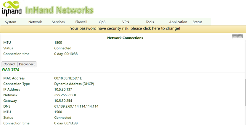

2. Go to Statusànetwork connections, confirm the Internet connection status in WAN mode, cellular mode and Wi-Fi mode. Make sure the mode of Wi-Fi is STA if using outside Wi-Fi as a backup.

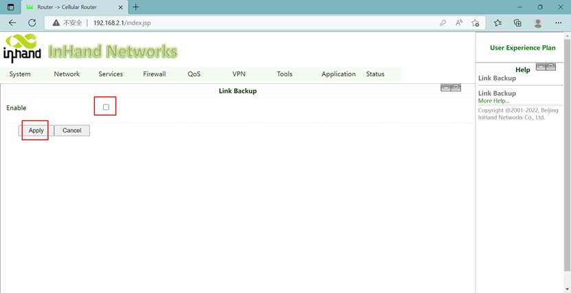

3.  Go to NetworkàLink Backup, check the Enable and Apply.

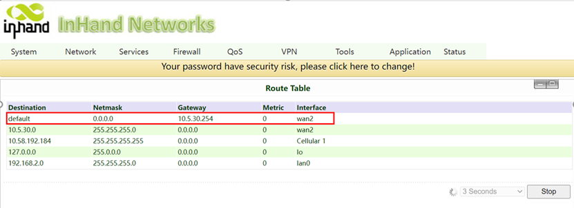

5. Go to StatusàRoute Table, to view the connection status as follows. The default route should be your main link.

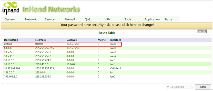

6. Test by disconnecting the main link from the internet and go to StatusàRouter Table. The default route should change to backup link.
7. After the WAN connection is restored, the default route returns to the main link.
