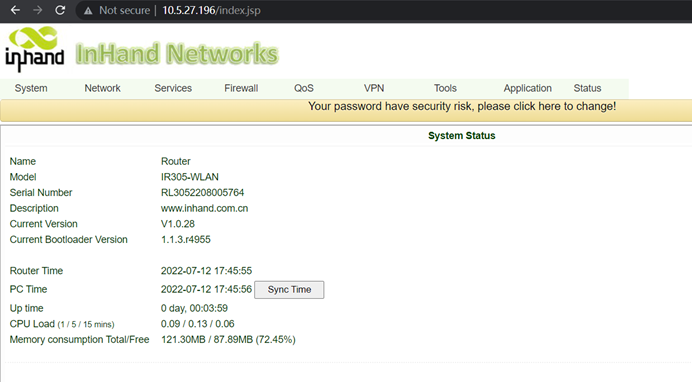

In this experiment, IR305 is directly
connected to the PC, and IR305's downlink device is IR302. The specific
connection is as follows.

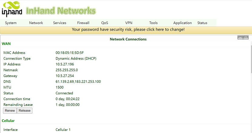

1.     Go to Status Network Connections to check the static IP of device. The external IP address
for this IR305 is 10.5.27.196 on its WAN interface. If you are getting a public IP from your cellular carrier, then find the public IP under cellular instead of WAN in this page.

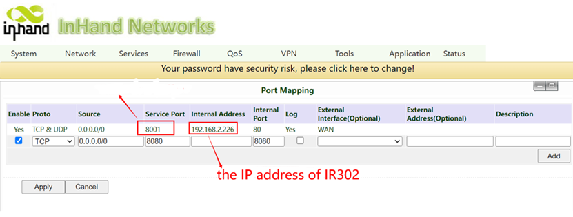

3.     Go
to Firewall
àPort
Mapping, fill in the Service Port and Internet Address.

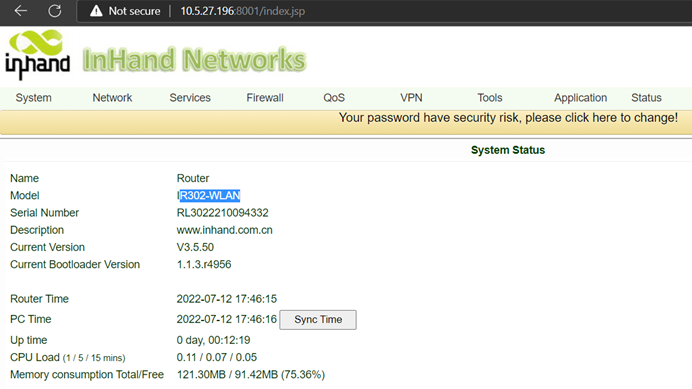

4.     Via
the IP address of IR305: Service Port,, you can access IR302 from other
devices. For example 10.5.27.196:8001. The result is as follows.
