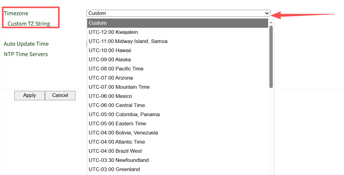

Log in to IR302, click on the menu bar "System" --> "Time", and then click on "Sync Time" under this section.
At the same time, you can also set the TimeZone according to the location of your area.
