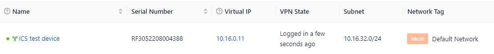

If the router is online, but the virtual IP is not turning blue or clickable, then the VPN is not established successfully.

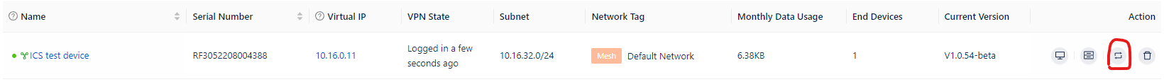

1. Press the icon circled in red to push the VPN configuration again to the router.

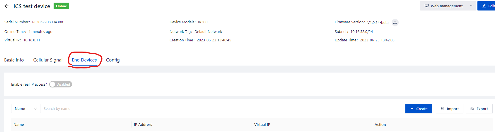

1. Click the name of the router you have your end devices connected to. The page open will give you more information about this router, and you can add the end devices information by click End Devices.

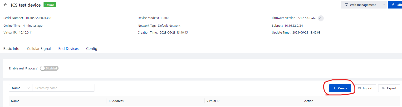

2. Click on Create and fill name and IP address for your end devices. Please setup the IP on your end device to static and within the same network as the router.

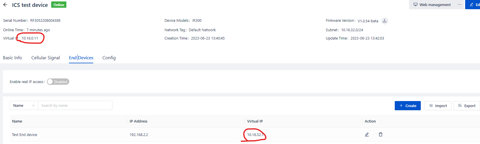

4. Find out the virtual IP addresses. Use the virtual IP to access your router and end devices
