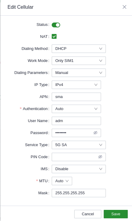

Hi,
we are currently testing the equipment in connecting our Private 5G network. Configuration from the "Internet" page has been done, as in the attached picture. We do not have authentication method, but there is no "None" selection in the combo box. We left it unmodified.
