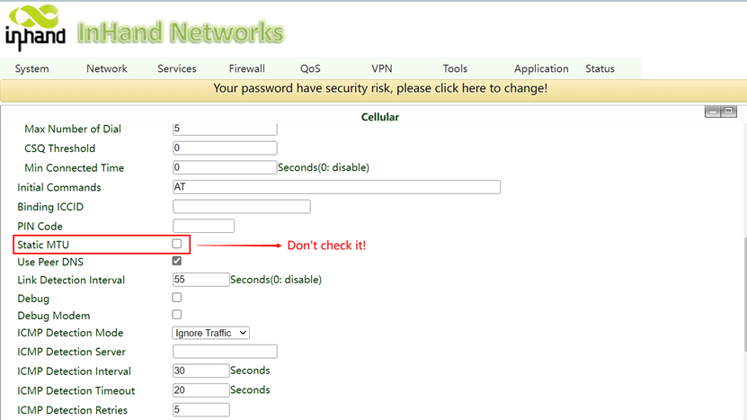

4. How to set MTU on Inhand devices?
Go to NetworkàCellular, check the Show advanced options, scroll down to MTU, and confirm uncheck the static MTU.

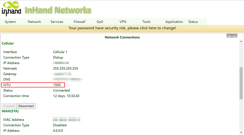

And you could check MTU of your device via
Status
àNetwork
Connections.
