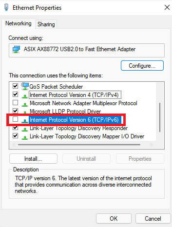

3.  In the same Ethernet Adapter properties in Windows, uncheck Internet Protocol Version 6 (TCP/IPv6), the adapter could be set to IPv6.
