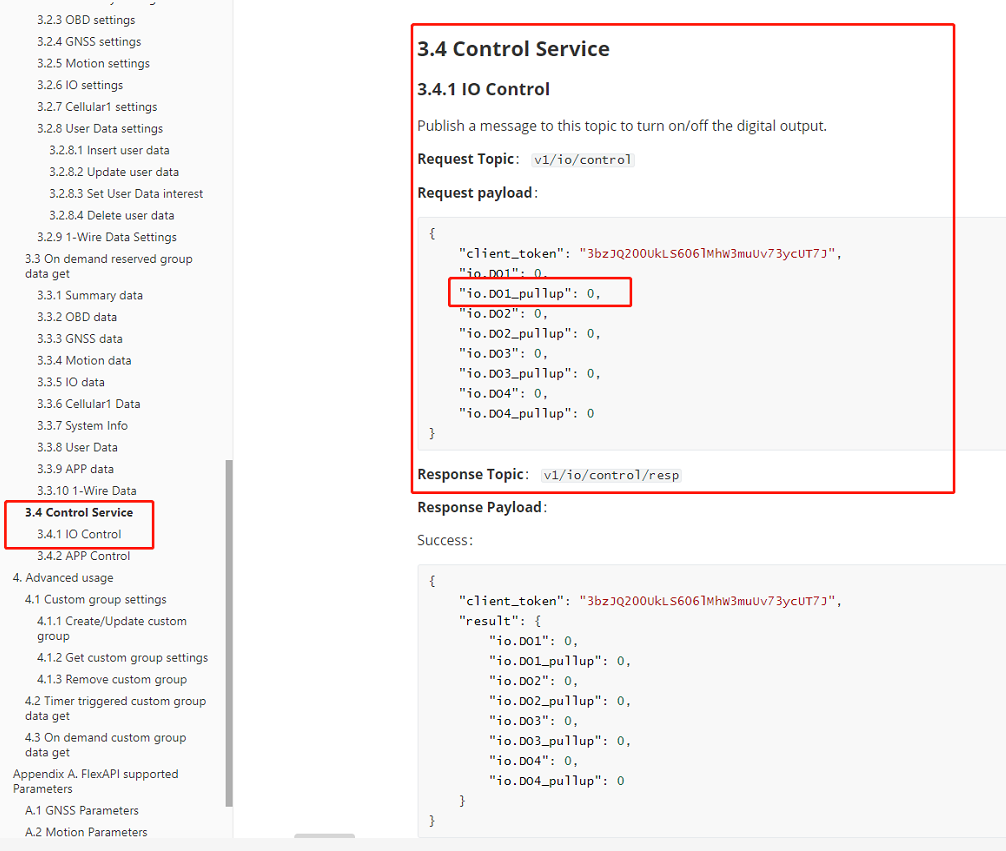

VG710 Control of IO
VG710 Control of IO
For the control of DO, if you disable the pull-up (set the pull-up to 1), DO can only output low (0) and cannot output high (1). After enabling pull-up, DO can output high or low according to the logic of control.
