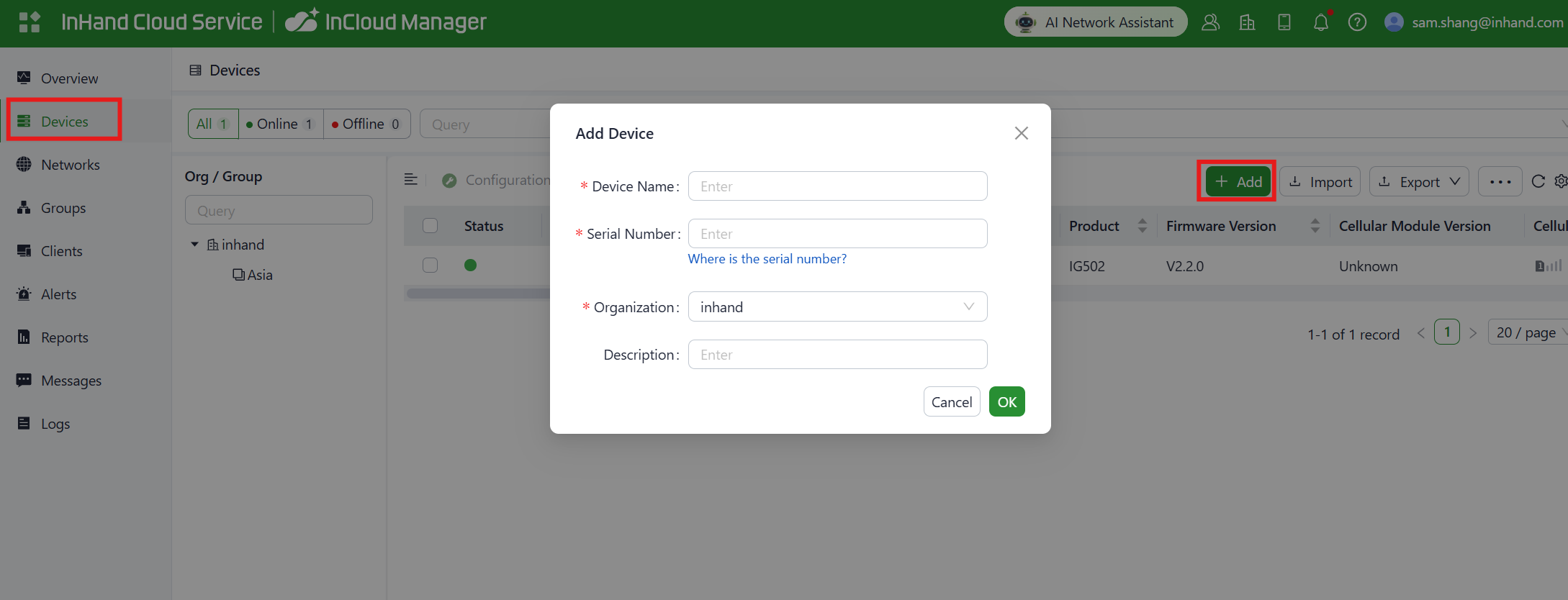

Click '
Add
' on the
'Devices'
menu page. In the '
Add Device
' popup, enter the
device name
serial number
then click '
Confirm
