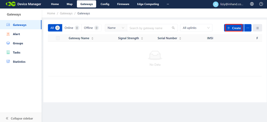

How to connect IG series with Device Manager Cloud platform?

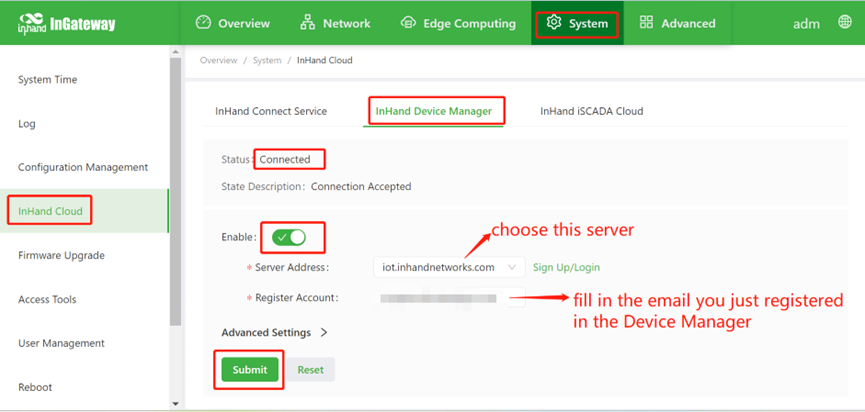

2. Then log in IG502, then follow
the guide below. Kindly remind that make sure the IG502 is connected with
Internet.

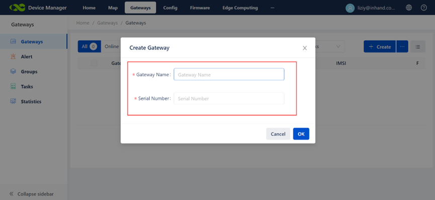

4. Fill in the Gateway name and
Serial number, then click OK button.

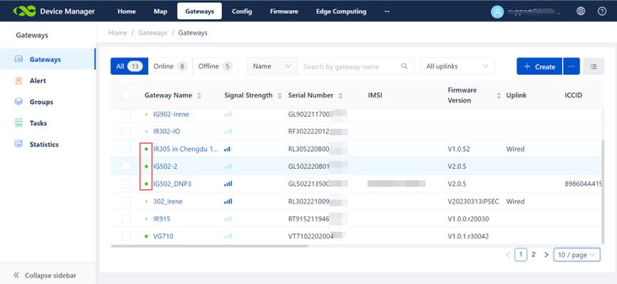

5. When the light shows green, it
means connected successfully.
